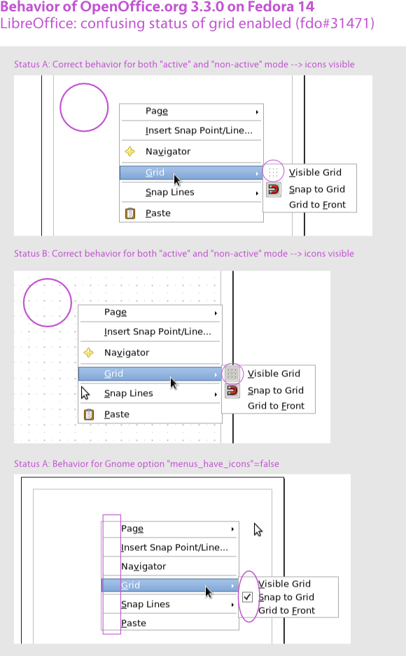

Concerning the issue, I can confirm some weird behavior in LibO 3.3.1 -
but, everything is fine in OOo 3.2.0 (quickly checked). I don't know why
"we" cause this issue ...
What is the correct behavior?
I have attached screenshots that shows the current behavior on Linux
GNOME x86_64. It shows the grid icon when the grid is disabled. It shows
nothing when the grid is enabled. I think that it does not follow the
specification. It should always show the grid and visualize
(border/background) whether it is selected or not.
Correct, it should always show the icon.
Thanks for the screenshots - I also created some and added it to the bug
report. Direct link:
https://bugs.freedesktop.org/attachment.cgi?id=44142

Note that the same problem is with the "Snap to Grid" menu item. The
icon nicely visualize the purpose but it not shown when the feature is
enabled.
Note that "Grid to front" menu item uses the checkmark, so it looks
weird.
True, but I also would omit a picture for that feature - so at least
here, it behaves according the defined behavior.
Furthermore, there might be an additional issue when using one of the
newer Linux distributions, since Gnome decided to deactivate the images
in the menus. Thus, the images have to be replaced by real checkboxes,
although the specification above is different in this case.
I use GNOME and I see icons on many menu locations.
It is based on a gconf configuration item; the Gnome default is "off".
Maybe the distribution turned it on ...
