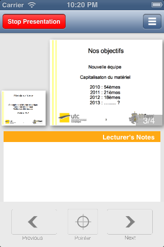

* I don't quite understand the layout slide show control pad. Why is the
next slide shown on the left whan one gets to it by swiping to the right?
Why is it shown at all?
First, I did not stick to the Android app which used a coverflow to change
between slides because it's to me a little bit trickier to change to next
slide by swiping. It doesn't seem to be as reliable as to simply click on a
button. With a button, users don't even need to look at the app to know if
they have swiped to the next slide or the next next slide... It was pointed
out by Michael M during the initial proposition period as well and that's
also why I made two big buttons for users to reliably control the
next/previous slide.
Second, the reason I show a secondary slideshow preview is twofold: 1. It
can be helpful for users to know what's the next slide, especially when the
presentation is at the last slide, in which case the next slide will be
black with a big "SlideShow Finished" on it 2. The screen size of iPhone is
much narrower and shorter than most of the android devices, which makes it
impossible to present only one slide while leaving enough space for the
lecturer's notes and the buttons on the bottom (if we maintain the aspect
ratio of the slideshow of course). If we want to keep aspect ratio of the
slideshow image, it presenting two slides at the same time seems to solve
the problem.
[image: Images intégrées 1]
[image: Images intégrées 2]
However, it does make more sense to place the next slide to the right. I
will change that soon.

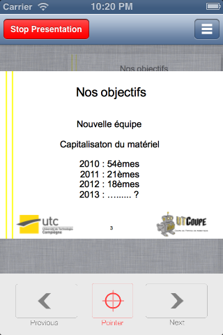

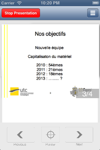

* What does the Touch Pointer in settings do and how is it different from
the Pointer button in slide view?
The "Touch Pointer" option, when disabled, activates accelerometer based
pointer. But if at the end of gsoc I don't have a reliable accelerometer
based pointer, I will remove this option and makes it touch pointer only,
The pointer button, in "touch pointer" mode, will display an enlarged
current slide, which allows users to touch the desired part more
accurately.
[image: Images intégrées 3]
In "accelerometer based pointer" (which is highly experimental), users can
keep holding on this Pointer button and a pointer will be shown on the
phone, which can be moved based on accelerometer. When users release this
button, the enlarged picture and the pointer will be dismissed.
