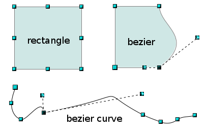

A bit on Bezier-curve handles in Draw:
Attached is a screenshot attempting to show the difference of those, compared to the resizing handles. There's a slight circular shadow effect on the Bezier handles. (Is it possible that they're supposed to be circular but are suffering from the alpha transparency bug mentioned in the other thread ?)
Anyway, in most decent drawing applications I know of, Bezier points are circular and Bezier handles either circular or triangular; IMHO that gives a better impression on how they work (can be moved in all directions = are vectors).

Attachment: Handles-Draw.png
Description: PNG image
