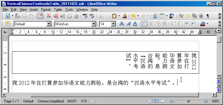

Just to make sure that everyone involved in the discussion knows how to use this feature:
1. Create a table; set "text direction" to "right-to-left (vertical)"
2. Enter some Chinese (or Japanese) text into the table. (In my case, the text appeared rotated.) 3. Change the font to one that was developed for Chinese (or Japanese, as the case may be) text.
You will now see the characters in vertical columns that should be read right-to-left.
So "text direction" is about horizontal vs vertical (i.e. vertical, then right-to-left), rather than the direction of the writing system (left-to-right vs right-to-left/bidirectional).
I have attached a sample document and a screenshot to this mail. The text below the table is identical to the text inside the table - in fact I copied it from the table. Also notice the change in quotation marks and the direction of "2012".
(See also this Wordpad screenshot from Wikipedia: <http://en.wikipedia.org/wiki/File:Wordpad_vertical_text_support.png>.)

> These options doesn't touch the text directionality (RTL/LTR) but only
> decide whether it goes horizontally or vertically.
