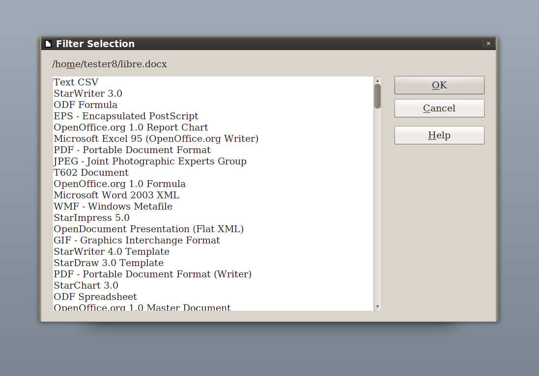

I am trying to track down how LO is handling the Filter Selection
dialog found
here: https://bugs.freedesktop.org/attachment.cgi?id=55136
        :-) that does look bad.
I have tracked down the framework
here: http://opengrok.libreoffice.org/xref/core/uui/source/fltdlg.src#45  but am yet to see how
the actual list is being generated inside of the dialog. Any guidance greatly appreciated.
        Right - so each .src file (that describes a UI resource) has an
associated .cxx file that refers to those resources using these magic
defines:
     45     ListBox LB_FILTERS
        so:
$ git --no-pager grep LB_FILTERS
uui/source/fltdlg.cxx:    ,   m_lbFilters  ( this, ResId( LB_FILTERS, *pResMgr        )
        usually they are next to each other like this. So:
http://opengrok.libreoffice.org/xref/core/uui/source/fltdlg.cxx#91
        Looks like a good method to do another git grep on to unwind this. Why
we're getting that filter dialog for a .docx file though - that is
interesting & prolly a different issue ;-)
